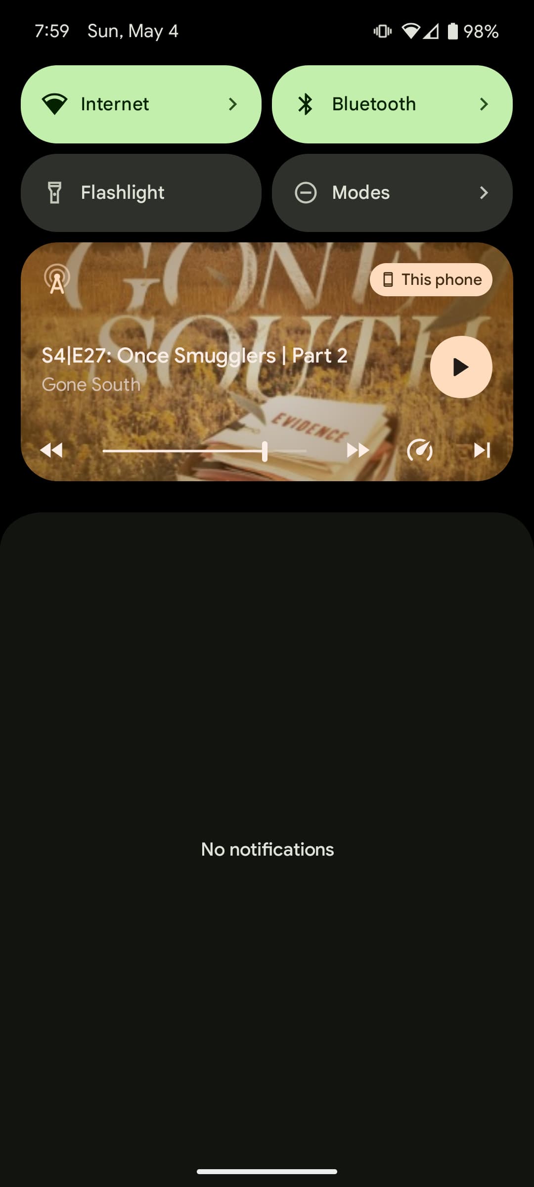

Do you mean you swipe down from the top of the screen like this? I think this is called the Notification Shade. Seems doable but not perfect.

Almost. If you do two swipes down, a pencil will appear between Modes and the Notification. From there you can move up the Anntenna Pod to be one of the top four. Mine is in the position of your Modes
Ah, thanks! I didn’t know AntennaPod had a quick tile. Seems it only pauses and plays, but it does seem pretty easy to hit without looking too hard.
