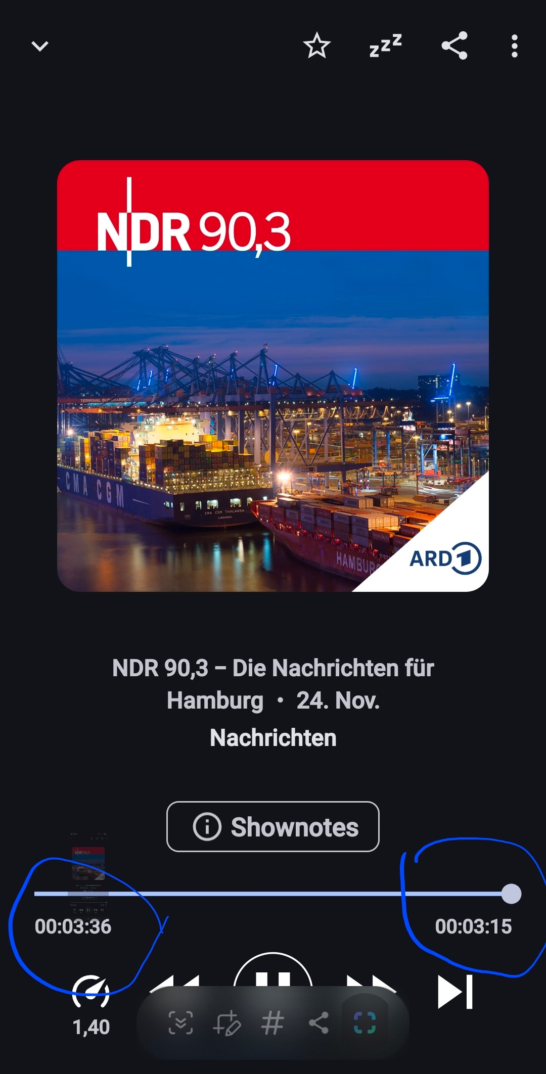

With every episode, I encounter an issue at the end: the app does not automatically skip to the next episode. Instead, it shows a playback duration longer than the actual episode length, and only silence is played.
This behavior rarely or never occurs with other podcasts. I usually listen at 1.4× playback speed.
The problem may be related to how the episodes are published or how the feed is interpreted by the app. I wanted to bring this to your attention in the hope that it might be possible to improve this behavior.
